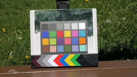

"Natural" Contrast Tests:
Results where EV = +0:
+0 121.7 (taken from Comment #5 & 6 above, Apr 26 & May 13, 2020)
-1 105.3
-2 101.9
-3 94.2
-4 95.9
-5 94.1
The first thing you will notice "Contrast +0" = 121.7 but for "Contrast -1" = 105.3 which is a big jump. And then it back-tracks from "Contrast -3" to a higher value at "Contrast -4". This is what happens in real-world testing situations. Seemingly random factors can affect results.
In this case, I think I understand what happened, and it has to do with the angle of the sun changing, and clouds passing over. Ideally, I would go out and re-do the tests, but I don't have the time. And besides that, the tests showed me what I wanted to know.
What I learned is that the changes in contrast are not huge between settings. If you look at the pictures, the differences between two adjacent settings (like -3 and -4) are hard to tell unless you look at them consecutively on a screen, flipping back and forth. It would be hard even if they were side-by-side.
NOTE: All the video clips recorded for this set of tests were accidentally focused on the background instead of the card. Since I am not reading pixel data near the edges of the colour samples, that should not affect the test results. In fact, it might even make the readings more accurate.

Natural
Contrast -1, Exposure +0
"g85-01-080-Natural-ConMns1-EV0-16h26m43s354-C1.jpg"
"Black" Luma: 93.8
"Black + 1" Luma: 119.1
"Black + 2" Luma: 160.4
"White - 2" Luma: 197.2
"White - 1" Luma: 224.4
"White" Luma: 248.6
Contrast: 224.4 - 119.1 = 105.3
