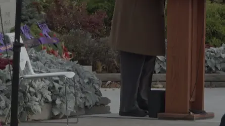

"AX53-C0011-01-Crop1600-C1.jpg"
- an unadjusted detail crop from 890,1250
- includes the wreaths on the left and the shrubs on the right, and concrete which could be used for white balancing.
"AX53-C0011-02-Rsz1600-C1.jpg"
Corel Smart PhotoFix
Brightness
Overall 28
Shadows -10
Highlights 20
Saturation 8 [Recommended 16]
Focus 52
Black 2
White 28

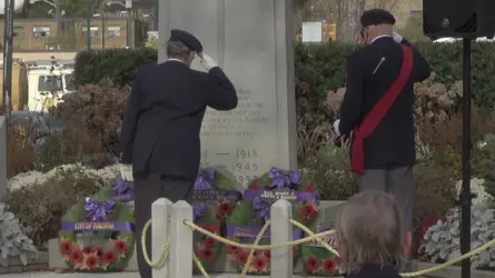

- Caps @ 43 sec.
"01a-C0014-00-43--Crop1600-C1.jpg"
Detail Crop from 1550,1570
- Focus looks wrong to me. But depth of field saves it.
"01b-C0014-00-43-SmrtFix-C1.jpg"
Corel Paintshop Pro Smart Photo Fix
Brightness
Overall 28
Shadows -30
Highlights 20
Saturation 15 [Recommended 15]
Focus 46
Black 14
White 8
