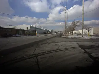

"P2060002-1a-rsz1640-C1.jpg"
- unadjusted conversion from DNG (raw) file, resized to 1640 x 1231
"P2060002-1b-Crop01-C1.jpg"
Crop from (2570,1400), size 1200 x 900
- look at the street light tops left from the billboard
- these are big enough to show the edges blurring from the left most to the right most. The blurring increases with distance.

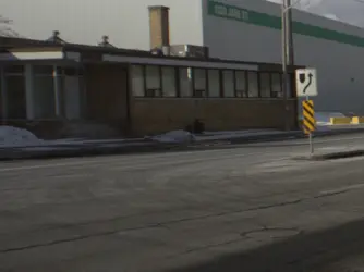

"P2060002-1c-Crop02-C1.jpg"
Crop from (2100,1400), size -1200 x 900
- The "traffic island" sign and its post are not wonderfully sharp, but it does show the color fringing, and that the sharpness is not being lost in the nearer objects. They are probably a bit sharper, but the difference is so little that I will not claim to be able to tell.

"P2060020-1a-rsz1640-C1.jpg"
"P2060020-1b-Crop01-C1.jpg"
- again, look at the street light tops left from the billboard
- The blurring still increases with distance.
This is also true of the hand rail on the far side of the bridge. I think it is more visible in this F8.0 picture than in the F4.0 picture
"P2060020-1c-Crop02-C1.jpg"
The "traffic island" sign and its post are sharper, but it still shows the color fringing, and that the sharpness is not being lost in the nearer objects. They are probably a bit sharper, but the difference is so little that I will not claim to be able to tell.

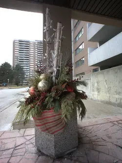

"P2210007-1a-rsz900-C1.jpg"
This image has been resized to 900 x 1200 which gives a reasonable estimate of how this lens would perform in a 1280 x 720p video frame.
The general detail level is pretty good, however, I would not really want to use it wide open due to the "milky" appearance which, for now, I am attributing to flare. Using F5.6 reduces the flare to a more acceptable level (and sharpens the image), so I would probably rate this as an F5.6, 1MP lens.

"P2210016-1b-rsz-1231-C2.jpg"
This image has been resized to 1230 x 1640 which gives a reasonable estimate of how this lens would perform in a 1920 x 1080p (Full HD) video frame. This file has been compressed one level more than the other files (C2) in order to make it uploadable. There is some detail lost but it is still higher quality than most 1080p MP4 files, so it is still a good indicator of potential 1080p performance.
There is not much to say about this image beyond the obvious. It is sharper and more detailed than the F4.0 image, and does not have the "milky" appearance. If you want some idea of whether the lens could be used at 1080p you can tilt your monitor on its side and view this image. Of course, you really do not have to do that. If you zoom the image and look at the detail level you should have some idea of the performance potential. Personally, I think that the sharpness and detail, though not "wonderful" will probably be adequate -- at F8. But that makes this a very dark lens for such usage. I will be testing F5.6 for video usage as soon as I can because realistically, I do not record all my videos on sunny afternoons.

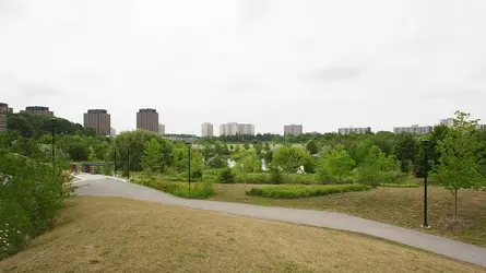

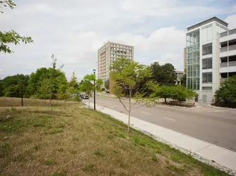

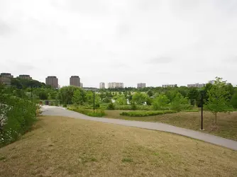

"P7230011aJPG-rsz1900-C1.jpg"
This crop shows the theoretical sensor usage of the YiM1 when recording its UHD videos. It is encouraging that a true UHD frame size resulting in a file that was much too big to upload. I had to reduce it to 1900 pixels wide to get an small enough image file at C1 compression. The sensor crop compensation for an equivalent 35mm view was 2.4x. This makes it roughly equivalent to a 19.2mm lens view when recording UHD.
"P7230011bJPG-1640cropC1.jpg"
This detail crop shows the POTENTIAL sharpness and detail of this LENS when used on the Yi-M1. You will NOT actually get this level of sharpness and detail during an actual video recording because the compression method is different between a still image and a video.
"P7230019.MP4"
- Not uploaded
- Focus is on the farthest buildings near the middle of the frame.
- Exposure is +2 (spot metered)

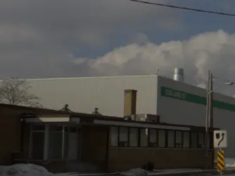

"P7230019-Big-2048-C1.jpg"
I recorded videos using the Yi-M1 "2K" format. The videos were 2048 x 1536 frame size and used the full sensor area. I then captured frames. Both these image are full sized and unaltered except re-compressed using JPEG at full detail (C1) compression. This first is the full "2K" frame.
[2018-07-26 02:38 reworded for clarity.]
"P7230019-Big-FullHDcropC1.jpg"
This image file is cropped to represent the image coverage of the Yi-M1's "Full HD" video. It is probably a very accurate representation of the image quality potential of the lens and this camera for Full HD MP4 video.
Would the Lens Perform Better On a Different Camera?
The sensor crop for the Yi-M1 when recording UHD is greater than many other M4:3 cameras, and the image quality of the Yi-M1 is already pretty good. Would this lens be good enough for UHD on some other M4:3 camera? That is an interesting possibility. I would need to do such a test to say for sure. However, if you do not have this lens, then I think the real question is whether it is worth buying, and I think the obvious answer is still that if you can afford one of the better lenses, you might as well do so.
see: "Micro 4:3 "Very" Wide Angle Rectilinear Lenses"
[2018-07-30]
- adding 2 more image files:
"P7230011_JPG-rsz1640-C1.JPG"
This is the whole still image frame resized to 1640 x 1230. There are no adjustments beyond the resize.
"P7230011cJPG-Crop2Crnr-C1.JPG"
This is the upper right corner of the whole 20MP still image frame. This is at full resolution with no further adjustments.
