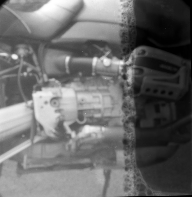

Unfortunately, the position of the pinhole disc, although a pretty good focal length, was in a tunnel created by the shutter assembly so the images although not bad for the first hole making attempt were heavily vignetted.
HP5+ mostly sunny 5 - 6 sec Image area on the 6x6 neg only 2 1/2 cm dia.

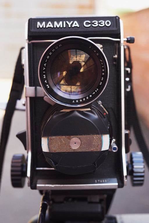

I'm trying something similar with my C330 but not got the pinhole sorted yet
This pinhole seems way too big. What did you do with the glass ?
