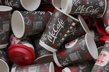

I bought this lens to test the LA-EA3 Lens adapter on my a5000, and hopefully, to use thereafter if it showed good performance. On the LA-EA3 adapter there is no "auto-focus", but "auto-aperture" is supported, as well as some EXIF data.
The lens has only two control rings, the Focus and the "Zoom". There is no aperture ring. The focus ring is at the very front of the lens and seems to be intentionally small so one does not accidentally affect the auto focus. Focusing turns the front lens element, including the filter mount (bad for polarizers).
Using the LA-EA3 Lens Adapter
The adapter is well made with an apparently strong tripod mount. It controls the aperture for exposure, but there is no support for depth of field preview. I think the only way I can preview the depth of field is to record a video clip.
My first tests were taken at about 2' - 3'. I mounted the camera on a monopod but as I was moving around I decided to just take it hand-held, so the monopod was just dangling in the air.
First Sample Images:
"DSC00293.JPG"
Partial EXIF:
Width 5456
Height 3632
Bit depth 24
Colour representation sRGB
F-stop f/5.6
Exposure 1/80 sec.
ISO-200
Exposure Bias -1 step
Focal length 50mm
Max aperture 4.640625
Metering Center Weighted Average
35mm focal length 75
Brightness 3.97421875
Original file size 5,865,472 bytes
I have the RAW file for this picture, but I am using the camera created JPEG.
"DSC00293a-rsz1640-C1.jpg"
- no adjustments except for resize to 1640
- compression is JPEG minimum to preserve detail.
"DSC00293b-Detail01-C1.jpg"
- no adjustments except for the crop
The detail crop does not start in the far corner. I started it a bit lower at "0,900" because there are points along the bottom rim of the upside-down cup on the far left and the cup on the upper right, and the rim of the red lid below that cup which are in proper focus and are the best places to judge the sharpness.
Note that at 1/80th sec. (hand held) it is possible that some sharpness might have been lost to motion blurring.

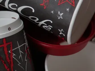

I think that most people will find this project less interesting than I did, and as sample images for an equipment test it is going to be hard for people to see the lens characteristics through the unusual subject matter characteristics.
This is a complete re-do of the earlier picture set. The cups are in a box and I emptied it and re=loaded it. There was more light this time, and I used the monopod properly (with it actually on the ground), so it is no surprise that it whole picture is a bit sharper, but these are only early tests. This will probably be the last set from this particular setup. I will probably re-do it with other cameras and lenses, but I think I have learned all I want from this one.
So what is there to see? The first thing you can see is that in both the earlier test image and this one, there is no colour fringing, all the way out to the corners. These are in the "middle" focal lengths (50mm and 60mm) and the earlier F-stop was almost "fully open". The F8.0 of the second image is within the typical working range of the lens. I might work down to F11, and occasionally F16, but I would expect that F16 is as small as I would use since I expect refraction issues below that point. Since the sides of the cups are close to straight, it appears that there is little or no distortion in these middle focal lengths. In the second image set, the higher 1/200 sec. exposure time and properly used monopod eliminate motion blurring, so the sharpness is as good as it is going to get. I would call it "quite good" in the F8, but borderline at F5.6.
I would say that so far, the lens seems "passable to good" from center to corner for this APS-C sensor. My research indicates that in general, most of the low cost "normal" range Minolta zooms tended to be soft in the corners when used with for real full-frame film photography, and I expect that this is probably true for full-frame digital cameras. Whether the 28-100 was a generally better performer than some of the other similar lens Minolta produced is going to be the interesting question.
Hopefully I will test the far ends of the zoom later, with different, less difficult to analyze subject matter.
"DSC00297.jpg"
Partial EXIF
Width 5456
Height 3632
Bit depth 24
F-stop f/8
Exposure 1/200 sec.
ISO speed ISO-200
Focal length 60mm
Max aperture 4.96875
Metering mode Center Weighted Average
Brightness 6.57578125
Windows File size: (JPEG) 6,488,064 bytes
"DSC00297a-rsz1640-C1.jpg"
This is file is based on the JPEG image created by the camera and has not been altered except for resizing and re-compression. The compression is the highest detail that JPEG allows.
"DSC00297b-Crop01-1640-C1"
This is file is based on the JPEG image created by the camera and has not been altered except for cropping and re-compression. The compression is the highest detail that JPEG allows.
[Added 2017-12-12]
"DSC00297c-Crop02-1640-C1.jpg"
I am posting one last detail crop. I wanted one in the corner (which I had on the first picture) and one in the center (which was the second picture), but that "center crop" in the second picture was disappointing from a technical analysis standpoint. So this second detail crop is roughly top center (shifted to the right a bit), but it has a good look at the edge of a cup rim that can be used to judge sharpness, which is quite good. It also shows that I was not focussed where I thought I was. I had originally focussed a bit deeper in the cups. I must have changed it.
That brings up an interesting point. The focus on this lens really is touchy. The ratio of the lens barrel turn to focus is very fast. I remember over-correcting back and forth a few times before getting it right.

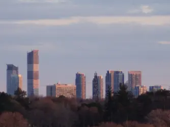

I decided that I would use more typical pictures for samples of this zoom and I think these are much better. These are sunset pictures. The backlighted trees and light fixtures give good references for analyzing sharpness. And there are structures that indicate linearity. I should warn however, that the road in the distance is not horizontal. It has a slight grade. So do not use it for a level horizon reference.
About the focus: I used the magnification but no "focus peaking". Focus is on the trees in the middle of the picture. These are very far away, but were not at "infinity". There are definitely trees further away within the pictures which are falling out of the depth of field -- even in the 28 mm wide angle picture, and even at this small an F8.0 aperture.
Wind was light to moderate. The camera was mounted on a tripod, sitting on grass, which was somewhat compressible. I used a 2 sec. delay to allow the camera to settle. Combined with the 1/400 sec. exposure times, there should be no appreciable motion blurring.
The uploaded files were made from the camera created JPEGs. Aside from re-sizing or cropping, no alterations were made. Re-compressing in all cases is the "least compressed" possible from JPEG, preserving the most detail.
"DSC00311.JPG"
Partial EXIF
Program name ILCE-5000 v.1.10
Width 5456 pixels
Height 3632 pixels
Color space sRGB
F-stop f/9
Exposure time 1/400 sec.
ISO speed ISO-200
Exposure bias +1 step
Focal length 100 mm
35mm focal length 150
Brightness 7.82578125
I do not think there is any distortion. If there is, then it is very slight. The lighting fixture on the left is relatively close and is starting to blur, so will take a detail crop from the right side and one from the center. At 100mm focal length I see no colour fringing. Sharpness is well maintained within the APS-C coverage.
- resize and recompressed
- right side crop and recompressed
DSC00311c-CropCtr1640-C1
- center crop and recompressed

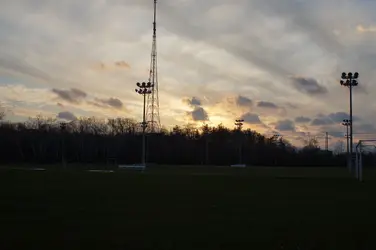

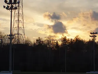

"DSC00312.JPG"
Partial EXIF
Width 5456 pixels
Height 3632 pixels
Color representation sRGB
F-stop f/8
ISO speed ISO-200
Focal length 28 mm
Max aperture 3.6171875
35mm focal length 42
Brightness 7.34140625
There is color fringing on the posts at the far right side of the image (and the corresponding trees on the far left, though it is hidden by apparent depth of field loss), but sharpness seems quite good for the telephone wires running through the middle of the image. There is just an hint of barrel distortion. Sharpness decreases more noticeably towards the corners, but is acceptable.
Other notes:
There is some focus shift during zooming. I think it would take about F11 to cover it.
As previously noted, focus is very quick which results in a bit of overcorrection, but it was more controllable in this set of pictures where everything is very far away.

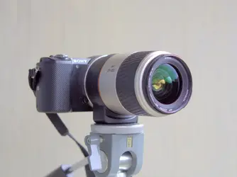

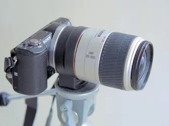

Sony a5000 w/LA-EA3 adapter
Konica Minolta 28-100mm f/3.5-5.6 D AF Zoom
on Slik tripod
Not one of my nicest looking setups
This is the setup I have been testing: The Sony a5000 with the Konica Minolta 28-100mm f/3.5-5.6 D AF Zoom using the Sony LA-EA3 adapter. Let me say that this is not the "prettiest" camera setup I use. Despite all three pieces being made by the same company at various times the combination of styles ends up looking awkward. The best I can say about the pieces is that they would all look better if I had bought a black lens. But I did not have that option.

Detail Crop:
From 4200,2800 (bottom left)
size: 2000 x 1500 [4:3]
The detail crop is taken from the original JPEG and has not been adjusted. If you check the detailing of the buildings you will see that sharpness and detail are very good. Only the image noise caused by the dropping evening light level mars this. I had seen in previous tests that this zoom performs better at the "tele" end than it does at the "wide" end which makes it particularly valuable for me because I am already "well covered" in the focal length range of the short end of this zoom.
In the sky, in the upper middle of this crop you will find a pair of dark "smudges". Those would be a pair of birds flying, probably much closer than the buildings. The long exposure is causing motion blurring. If the plane had not come along, those would have been the highlight of the picture.
"DSC01129c2-rsz1840-C1.jpg"
Crop Start 1050,360 [4:3]
Size: 3400 x 2910
End 4450, 2910
Smart Fix
Brightness
Overall 0 [Recommended 2]
Shadows 20
Saturation: 28
Focus: 65
White Balance No
Black 8
White 20
Resized 1840 (4:3)
The third image is my "preferred" crop of this picture, and it has my usual adjustments (exposure, gamma and colours, and sharpening). Unfortunately, the result was too big to upload, so I had to resize it. Thus it is not directly representative of the this camera and lens, but it is the picture that I will probably print out.
