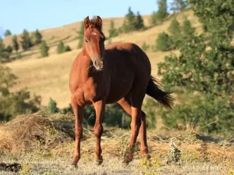

Hi there,
I have a very blunt question that hopefully safes me a lot of time with trying around, loading up pictures, trying again, ...
Sunny day, the sun actually in my back, and I want to take a picture of a moving target (horse), as sharp as possible, with a blurry back ground. The horse is probably about 100 feet away from me, and I am using an EF 75-300 mm Zoom lens.
What would be the best setting on my camera to achieve a picture like *** the one that can be found on my website where the picture is used with all rights given to me by the original picture taker. In writing. *** *** edited for copyright issues ***
I am aware that this is not a shot with the sun in the back - needless to say that I did not take this picture, either ;)
Thanks!
TPF forum rules/regs - Photography Forum & Digital Photography Forum FAQ - don't allow us to post photos that aren't ours.
We can post a link though.
If the horse is 100 feet from you and you want the focus as sharp as possible set the lens aperture to f/8 and the focal length to 300 mm. Focus will start falling off about 120 feet behind the horse, so if you want the background nicely blurred it will need to be 1/4 a mile or more behind the horse. Online Depth of Field Calculator
Set the ISO to 200 and then use the appropriate shutter speed to make a good exposure with the light you have.

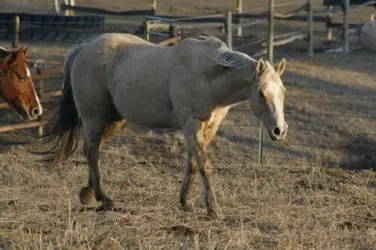

I gave the setting Keith suggested a try just before sunset. Pictures came out a bit dark so I hit ISO up to 400. I do have problems to find the right focus, though, in most pictures the one or the other part of the horse was blurred, probably because of movement too. I'll keep on trying, thanks for the starters!
These pictures were all taken on AV setting with f8, ISO400 and shutter speed was probably done automaticly by the camera ... What else do I need to keep in mind?
When you take shots check the viewfinder, even though in AV mode the camera is setting it for you it still displays the speed. If its not around 1/500sec or faster bump the ISO. Noise you can deal with in editing and exposing correctly at a higher ISO gives less noise than underexpsing at a lower ISO. In addition motion blur can't be fixed in editing*

Okay, call me stupid - how do I know the aperture of my lens? I thought (and I really don't know anything about cameras) I set the aperture any way I want?
Turn the mode dial to Av, use the scroll button and watch which numbers change, that's your aperture. Scroll it to the smallest number and zoom in all the way. It'll probably read 5.6 or 6.3. Set ISO to 100, and shoot. If you get motion blur bump your ISO up to 200 or 400. The last step is to get as close as you can, maybe even get real close an zoom out to 200 or 100mm
Check the manual which will have specific details as to how to change in the various modes. In Av mode you'll be turning the little clicky dial near the shutter button to increase (smaller numbers ) or decrease (bigger numbers - yes its backwards).
