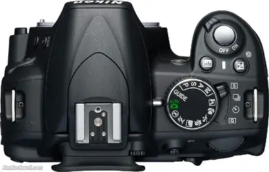

Rody, did you make sure the fall didn't turn the wheel to "no flash?" If you look at the top of the camera, as pictured below, one click away from "Auto" is the "no flash" option.
See if the flash will pop up by pressing the flash button next to the flash (slightly under the flash on the left hand side) while at P, S, A or M mode. If it can't something may be wrong with the mechanism. If it can, try resetting the settings to default and try again in dark room with Auto.

Ok, all joking aside, as mentioned above, check to make sure the wheel wasn't accidentally moved changing the settings. The D3100 does not have a lock on this wheel and thus is easy to bump out of setting and the pop up flash will not pop up in some of the settings such as "M, A, S, & P. the dial/wheel also has a no flash setting as well. So make sure the dial is set to something like Auto or Portrait.
Oh, i've turned that wheel 10 times in different directions, pressed that flash button too, did reset to all settings, restart...Nothing! Might need to take it to a specialist.

It's possible to cut the flash on/off in other ways.
There is a flash button on the left side of the lens, hold button while looking through the view finder, then turn the dial and look for a flash icon.
