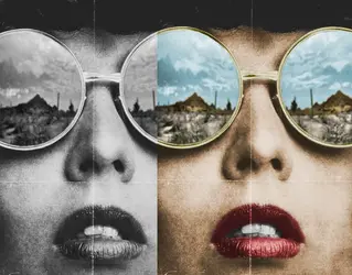

@480sparky and @smarty62 Sorry for the confusion! I should have been more clear.
I have 2 questions:
1. Why do the photos from the 50s/60s have this look?
2. Can it be recreated?
I'm using film as a starting point because it seems like the most natural way to achieve the effect I'm after. Ideally I would shoot on the film from that era, print, and then age the media for 40+years, but that isn't really a realistic option.
@Dave Colangelo I'm using a Pentax K2DMD with a 50mm lens. Played around with Velvia 100 slide film but have since switched to Tri-X 400 and colorized in post (attached example below). Might even get some Ektachrome when it's finally re-released. Haven't gotten to the printing stage yet, but recommendations would be welcome.
From what @webestang64 , @compur , and @Dave Colangelo have said, it seems like this look is a combination of film type, retouching (bw to color), era relevant clothing, ink printing, and aging of the physical prints.
Am I missing anything? Other aspects I haven't considered?
I know that technicolor is film process for motion pictures, but it's the closest word to describe the look I'm trying to re-create.
